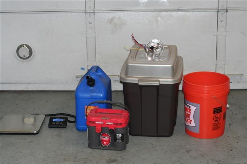

Here is the test equipment I used..
I weighed all my containers before they were filled up with gasoline and then weighted them after with 4 gallons in each.
Container................Empty weight............. With 4 gallons of gasoline inside
Blue fuel container........2lbs 8oz...................26lbs 8 oz.
Brown tubaware...........3lbs 8oz....................27lbs 10oz.
Pretty darn close to that 6lbs of weight per gallon of fuel configurations eh? By the way i didnt make that up. I researched and it seems alot of people agreed that 1 gallon of gasoline at 60 degree room temp weighs 6lbs.

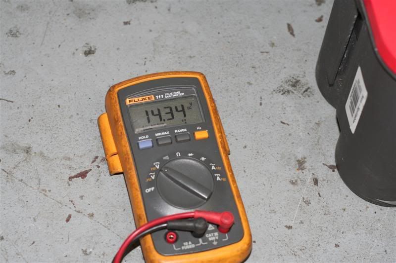

Next, I hooked the battery up to my truck with a jumper cable and kept the truck running so that we have consistant voltage at all times. The voltage were consistant between 14.3-14.2 volts at all times
Heres the little bad boy ready for testing, I am going to be testing with our stock fuel line kit and then with the -10 AN stainless kit

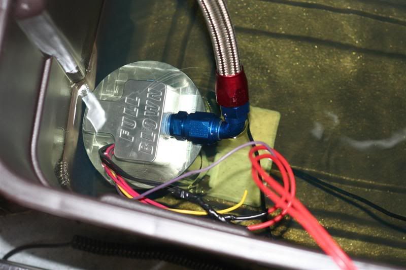

Here he is inside the tank

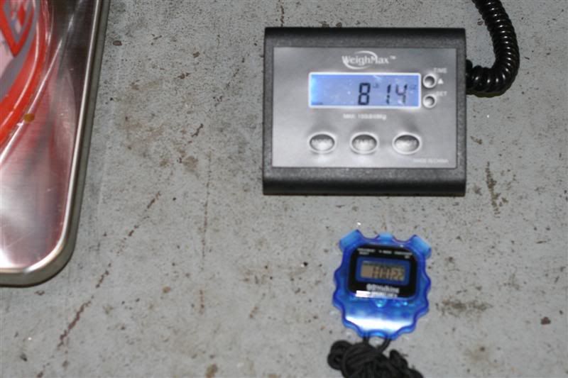

First test I am going to run a 5/16 fuel line from the Full Blown Twin Pump to the bucket that i will be measuring with my scale, and timed with a stop watch. I started timing as soon as I see the first sign of fuel coming out the line.

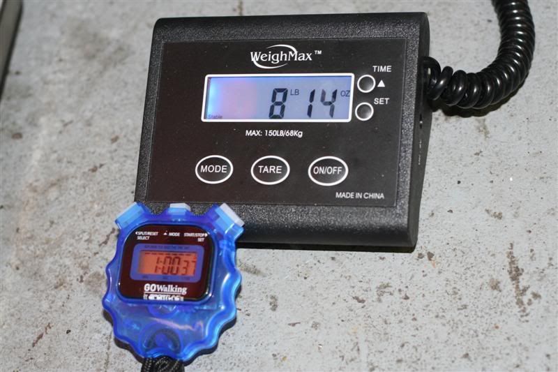

Here is the results of the FBM Twin Pump with just a single pump on for 1 min
Now here is the results with both pump kicked on for 1 min
Well, you guys are probally like DUH!! two pumps mean double the volume. This just proved that no they are not fighting eachother. Atleast not at 0psi of pressure. Please pay attention it could change later

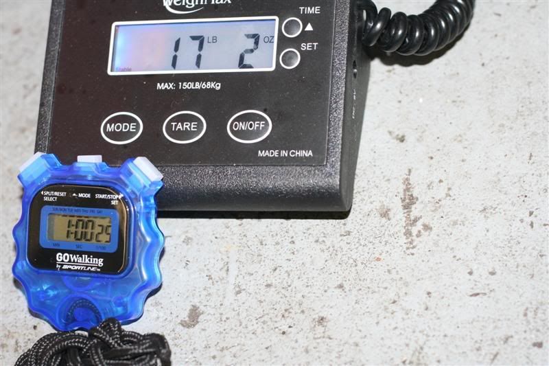

Ok Now on to the results for the -10 stainless with a single pump turned on, same as the test with the single pump

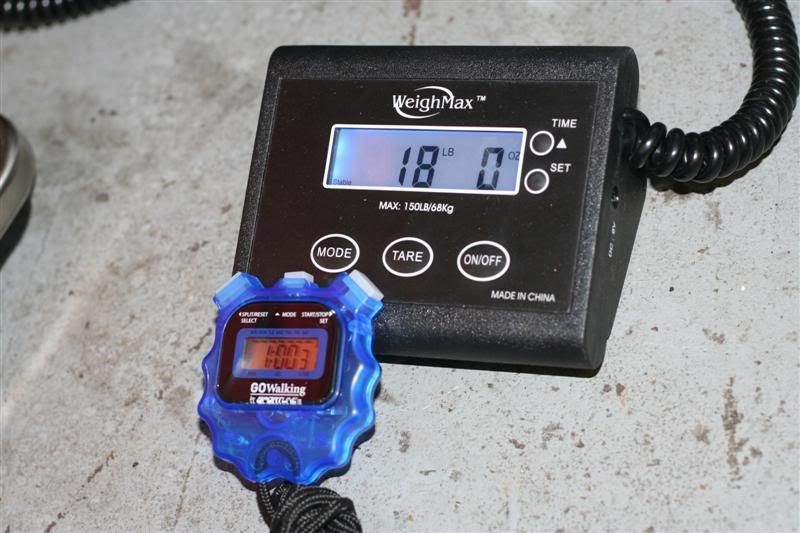

Finally we have the test with both pumps on with the -10 kit
So with the both pumps on, the -10 kit flows about 1 extra lb of fuel then the setup that has the stock lines configured. Lets break it down
1 gallon of fuel = 6 lbs
The Duo pump with the -10 flowed 18lbs per minute.
18 lbs x 60mins = 1080lbs per hour
There are 3.79 liters in a gallon
1080lbs / 6 = 180 gallons
180 gallons x 3.79 literes = 682.2 LPH
If we plug 17 into the equation instead of 18 for the stock line. We get 644.3 LPH

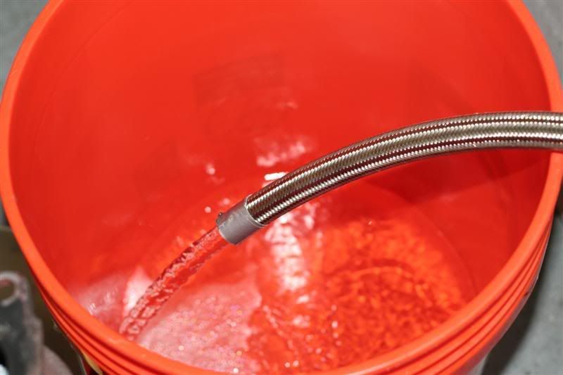

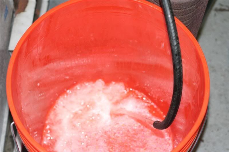

Here is a pic of the -10 with both pumps on, ahhhh.... its almost like someone is pouring you a nice cup of tea
Now the stock line unit, Holy cow its like a fricken horse pissing in your cup of tea!!! I actually got some fuel that bounce off the surface and hit my face cause i wasnt aware of the pressure
Conclusion, both pumps are not fighting eachother in the test. Also I think the stock line will work just as well as the -10 setup. But i dont know if it can compare to the -10 as pressure increases. Im sure you can make tons of power off the stock lines but e85 requires about 30% more volume then gasoline does and those stock lines might not cut it. This setup will work in any way you want it. We offer them in both configurations. Stock lines or -10. You can use it with any type of fuel you like, c16, e85, pump gas, anything you like. If I am wrong with any of the info, please correct me. I just did the test and computed some numbers. I am not claiming that i am right but this is just my opinion based on a test
